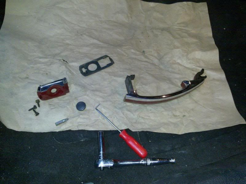

and so, i equiped myself with a selection of screwdrivers and torx bits, plus a rather usefull pointy thing with a bent point to help prise off any plastic covers that needed prising off

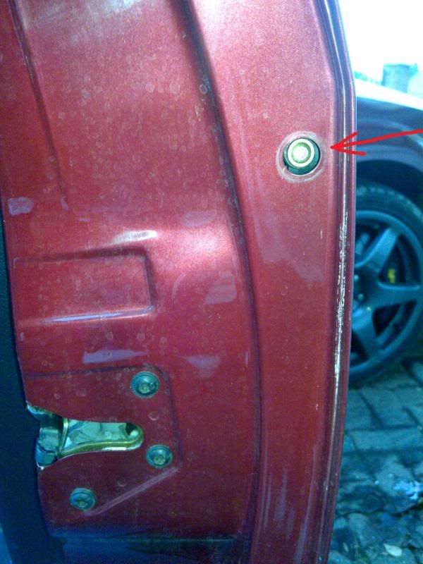

so, to start with, it was off with the door handle on the exisiting car, starting with undoing this torx screw, hidden under a plastic cover
you have to unscrew it a little to loosen the tab inside the small plate of the door handle, pull the door handle as if opening the door and pris the smaller big out, then pull the handle to the rear of the car to release it
this is what you will be left with

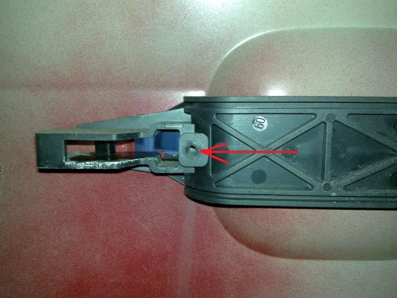

see this screw that's not there anymore?
it holds this in place, if you don't remove the screw you can't get it out, and the internals won't come out without damaging the door, remember to replace the screw when you put it together again as it aligns stuff
