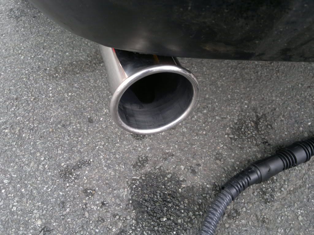

here is what i did -always temporary-
Was my answer useful ? - please press "thanks" : )

#8 totalguy
totalguy
    TDDI Buff
  • 37,014 posts
  • 388 thanks
  • Vehicle Driven:mondeo tddi
  • Location:Rhondda Cynon Taff
Posted 10 April 2012 - 09:49 AM
easy enough job really with the right tools :)
