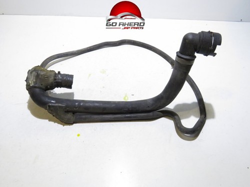

my car has a leak in the cooling hose and I requested the price for a new one to my local Ford and they told me it is no longer available. The hose in question is the item 2 on the attached photo. Doens anyone know where I can find this?

its an expensive used part but a seller on Ebay UK has one and will ship internationally, link below.
The other option if your plastic parts are ok is to buy hoses of the correct size and some metal linking tubes and make your own like people do when making custom hoses for modded cars.

Kits exist made specifically for the Mondeo V6 but they are crazy expensive, finding pipes with the right bends and linking them to make your own would be cheaper, its only got to go in the right directions and not be a 1:1 match of the original.
What is leaking, can you cut out just that section and add a new section in only in that place?
This is a pic of someone with a kit by Samco, that kit is loads of money, they exist but DIY is the far cheaper option.

if it were me, i would be looking to just chop out the leaking part and make that with pipes, linking tubes and jubilee clips.
Possible addition to the above get some self amalgamating rubber tape to help strengthen the pipes for the future.
What about the later part? 1202254
You can still get those brand new from Ford.
I got the part, not exactly the one, I got apparently the part suggested(1202254) and had to make some adjustments. The car is running now, apparently well.
