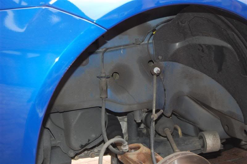

It dont look like this then??
2
no like this lol
remove pinch bolt and tap hub down away from the strut, then remove bolts on the strut tops in the engine bay...
sorry i should of thought it was on a newer one :)

looking back at some of my pictures, i did in fact do one side like that, well it looks i did :) it was all due to avoiding damage to the hydro bush, they do recommend dropping the subframe to do this job, but still we all do it different,
looks a nice clean car you have there, what model is it?
lol its not my car, just some pics from ukfn (ukfiestanetwork)
its a mk6 ST, i used to have one, p/x'd it for the mondeo :D
