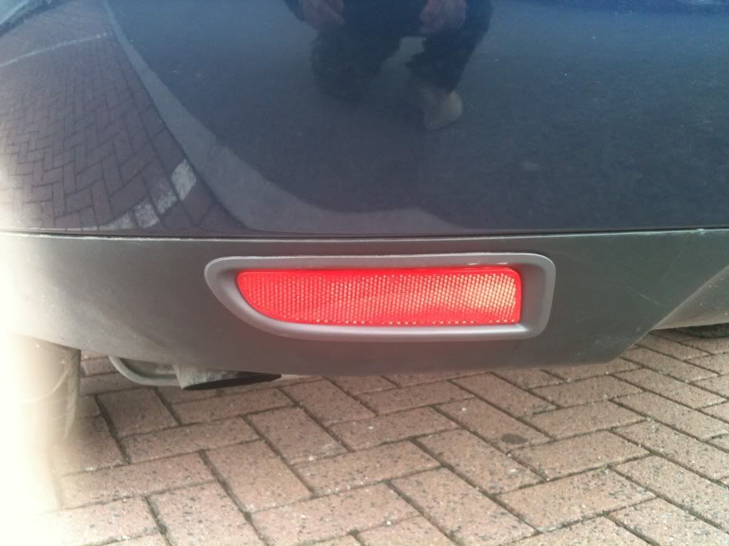

I want to add some reflectors to my lower valance.

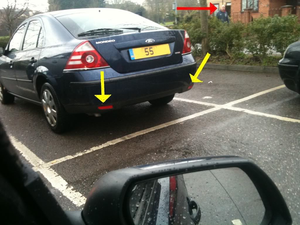

I took a pic of these ones today on a 55 plate (mine is a 52).
They almost look like they just sit, or stick on top onto the outside of the lower valance. Can I buy them on their own, or would I need to buy a whole lower valance?
Sorry about the big yellow arrows, but I could not resist adding them, after I had put the red one on, to show that bloke dogging me up as I took the photo......Maybe he thought I was a terrorist on a recce mission lol

IIRC there is a part of the valance which is moulded to take them. Maybe wrong but pretty sure it is.
Might be worth just getting a second hand valance with them on and swopping it for yours.
HTH
Here found a pic on ebay of a close up of the rear bumper.
As I said it has a moulded part in the valance

I rang Ford about this very thing the other day. The reflectors are £8.16 each and the inserts which the reflectors clip into are £9 odd... plus VAT on top of that lost as well. So £35ish all in.

Right, I have fitted the proper Ford reflectors.
It is not the easiest of jobs, as the reflector holder sits inside the rear valance, so you need to cut a hole out for it to go in!
It took quite a while to make my own template for the size of the hole, but once they were in they looked good.
2
Just thought I would put up some pics of the final results, just in case anyone else is brave/foolish enough (you choose) to be wanting to cut holes in their valance :)
